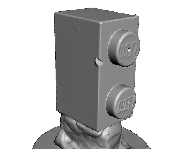

In short: You can create 3d models like this with only your Raspberry Pi + Camera and an internet connection (5 clicks --> 100 photos + 5 min of automated processing)

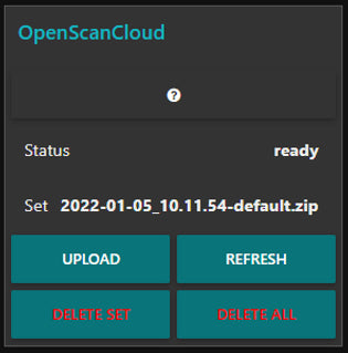

File Menu
In the file menu, you can select a stored image set and upload it to the OpenScanCloud Servers.
Refreshing will query the server for your stored image sets. This will update the status in the file table accordingly ('file approved', 'processing started', 'processing done', 'processing failed'). See the help icon for a detailed description

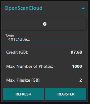

Settings Menu
In order to use the cloud processing, you will need to read&agree to the Terms of Use. Find more details using the little help icon :)
Upon first usage, you will need to register by giving your name + email address. Note, that I currently have to approve each request manually and thus, the confirmation email might take a bit ;)
Once you received the registration email, you can enter the token and use the cloud processing.
In case you run out of "credit", just send me a mail to cloud@openscan.eu. (In the future, i might remove those limits)
