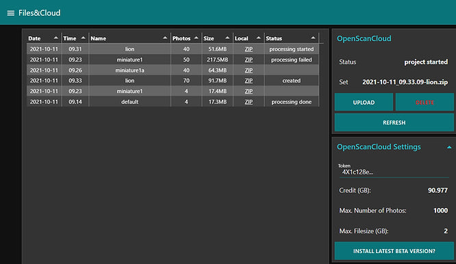

The firmware hasn't been changed a lot, and I only added two new panels to the right side of the Files&Cloud tab. You will always be able to transfer the zip-files to your local computer and do the processing manually.

OpenScanCloud Settings
The only thing needed is a personal token, which you can easily apply for by sending an email to cloud@openscan.eu. You will then need to enter the token in the OpenScanCloud Settings Tab (in this example: 4x1c1128e ...):
After hitting refresh, some associated data will be loaded from the server:
  • Credit - A number showing how much gigabyte you are currently allowed to upload and process. This value is currently limited to prevent abuse. Anyway, if you run out of "credit", just email me.
  • Max. Number of Photos: Is the maximum number of photos that are allowed in ONE set.
  • Max Filesize: in gigabyte is the limit for the file size for ONE image set/zip.
There will be some updates in the near future, and after installing this version, you will be able to get those updates by simply clicking the update button below. I will write blog posts about any major updates of the firmware, but you can also follow the project on GitHub.
Upload & Process image sets with OpenScanCloud
In order to start processing, you will only need to select an image set from the list and press upload. In order to upload the set, the file might need to be split into 200MB chunks. This step is fully automated and can take up to a minute, so please be patient. Those chunks will be uploaded and processing will be started as soon as possible.
You can always press refresh to query the current status of your projects, which should be one of the following:
  • created: The project has been successfully created on the server
  • initialized: All files have been uploaded and processing will start soon
  • processing started/failed/done: self-explanatory
