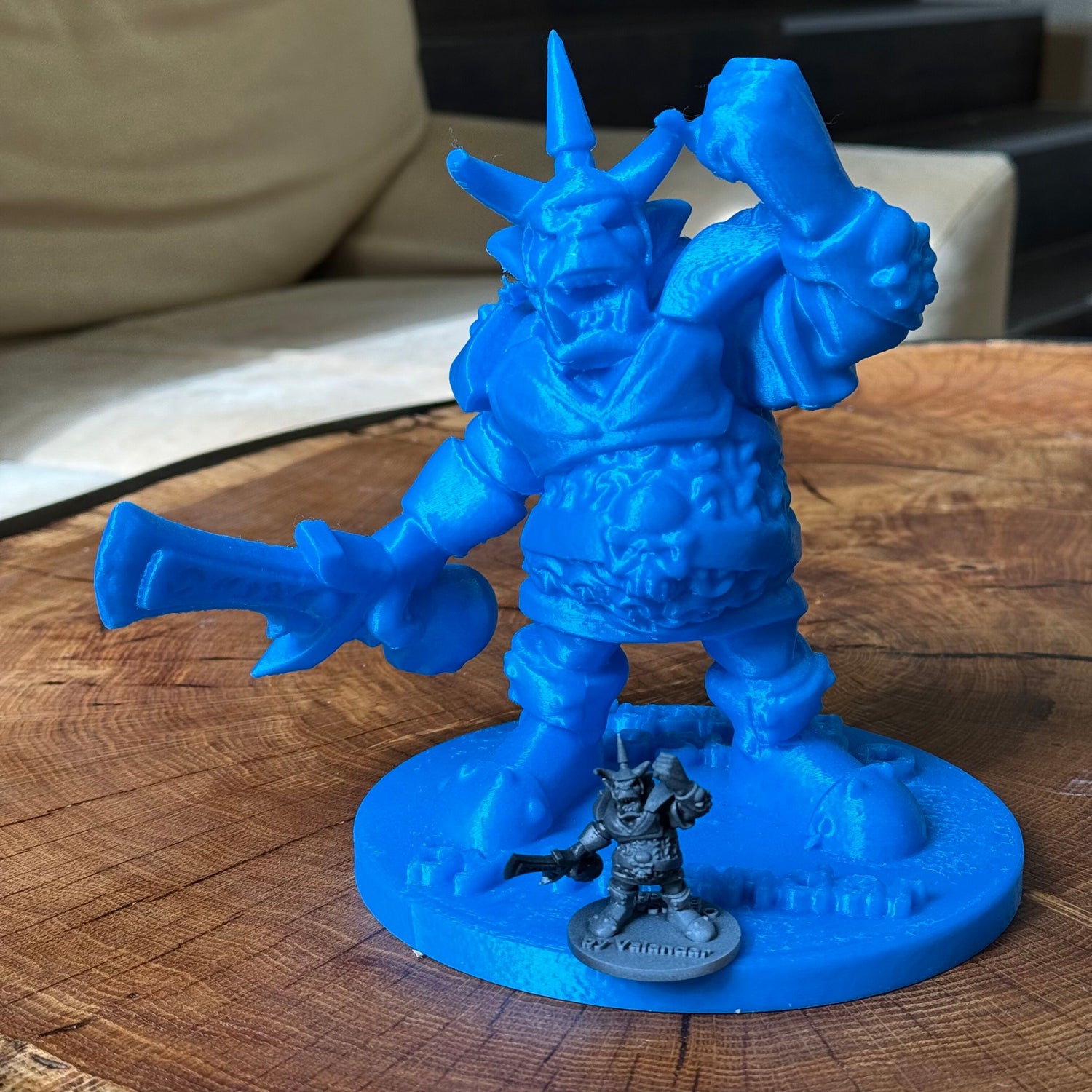

original in front and scaled-up copy done with the OpenScan Mini + Cloud
