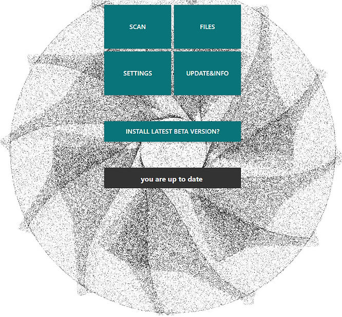

(6) IMPORTANT
Please let me know if you encounter any problems! There will be future beta-updates, which can be installed by clicking on the install latest beta version on the start screen (see first image)! Do not use the regular update-routine in the Update&Info tab as this will install the latest stable version (without OpenScanCloud + Access Point mode).
